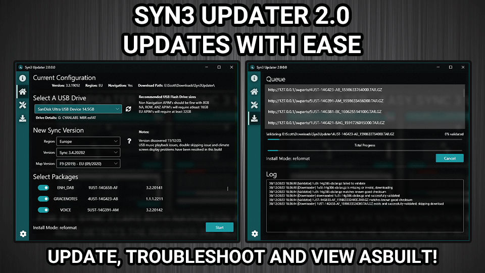

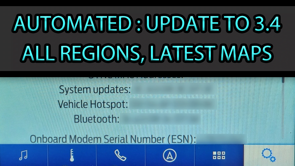

  • schon einmal diesen Weg versucht?
    Easily Update SYNC 3 Using Our Automated Method - CyanLabs
    A guide on updating your Ford Sync 3 based car to the latest Sync 3.4 version using Syn3 Updater making it as simple as possible for you!
    cyanlabs.net
    Syn3 Updater - CyanLabs
    Syn3 Updater is a Windows application that will make your life easier when attempting to update your Ford SYNC powered car to version 3.4!
    cyanlabs.net
    Download Updater:
    SYNC3 - Updater Download:
